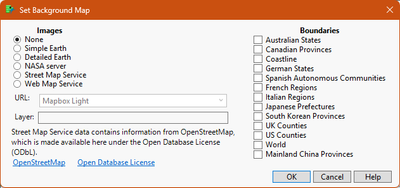

The JMP 18 graph builder menu (Graph> Background Map) only offers a few geographic options:

Has anyone successfully applied a custom background map? Do the map files have to be stored in the C:\Program Files\JMP\JMP\18\Maps directory, or can they be anywhere?

I tried to do it myself and I think I got it. So you will need basically to create your own background map or maybe your boundaries. As it is mentioned here Add Background Maps to Graphs: "The maps that you created from Esri shapefiles are also listed here. " So you would need to add your own map in the maps folder. In this webinar it shows how you can create your own Custom Maps.
So I just took the two files created there and added them to the maps folder of JMP (You have to go Help-> Sample Data Folder back two folders to the version number folder(e.g. 18) and then Maps. There you copy paste the two files you have created ( you can try with the ones from the Custom Maps webinar example Solar tracker-XY and Solar tracker-Name. Then they will appear at the boundaries section of the background map and you can add them there. This leaves the map shape free to add a shape of your choice.

I did come across a few of the resources you posted, they've been useful as reference for utilizing the map shape part of graph builder. Unfortunately none of them cover custom background map boundaries, which is necessary for the chip map since I've reserved map shape for another layer.

we should distiguish between
a) shapes (they are like fancy point plots, but with complicated shapes -  not in the background : )
b) background maps - which are added in the background of the plot via:
If you are interested in shapes, not background maps,  @spyros_megalou and @kristen-slappey provided the background information.
Concerning Germany and France, JMP is very clever, just drag the column into the map shape dropzone, that's it:
(view in My Videos)
When you want to use your own map shapes. you have 2 options:
a) set up a link between the indicator column and the -name  & -XY files via Column Properties:
b) place the -name and -XY files into the Maps folder. You don't have to put your files there but this is the easiest way to access the information. then without any link, JMP will find the corresponding Shape automatically and it will draw the outline. (like with germany and france)
Re: How to create a custom background map (not map shape)?
Great post to clarify, thanks @hogi. Just to mention that my second message is about how to create background maps add them to the maps folder and then add them from boundaries in the graph builder.
