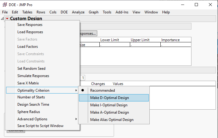

There you will find that D-Optimal designs are handled in Custom Design
Open
     DOE==>Custom Design
And then under the red triangle options you will find

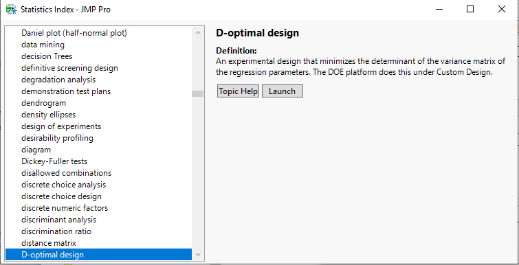

An easy way to have found the path to the D-Optimal design is through the Statistics Index in JMP.  If you go to
     Help==>Statistics Index
and scroll down to, or click on the selections and type in D-Optimal you will find
Jim
