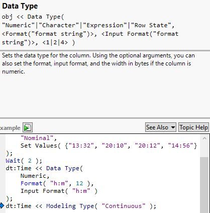

There is an optional form of the << Data Type message that combines all three steps:
So your code might change to:
Column( dt, "Cycle Time" ) << Data Type( "Numeric", Format( "min:s" ) ) << Modeling Type( "Continuous" );
See if that form works better.

Yep, that did the trick - thanks for the quick response!
