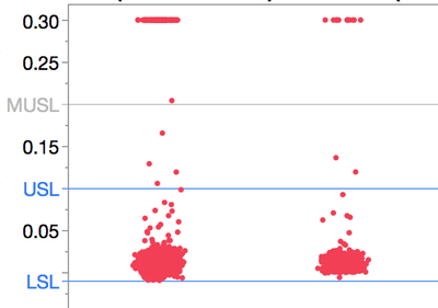

I have plotted 2 data sets in graph builder that looks like this:
Screen Shot 2018-02-21 at 9.57.31 AM.pngScreen Shot 2018-02-21 at 9.57.31 AM.png
The USL and LSL were automatically placed via the spec limits I set in the column properties and adding refrences lines to graph. I then additionally added a Marginal USL (MUSL) manually in graph builder.
To this graph, I would like to add a label or note with the count/sample size for each data set as well as the % of points above USL, above MUSL and below LSL. I would like this "label" to be automatically updated everytime i change the data. How can I do this?

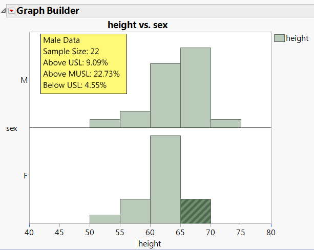

The embedded image in your post is not showing, so I'm flying a little blind here. I'm guessing you can probably do what you want using Add Text Annotation. Here's an example:
dt = Open("$Sample_Data/Big Class.jmp");
USL = 68;
LSL = 55;
MUSL = 67;
SampleSize = N Row(dt << Get Rows Where(:Sex == "M"));
AboveUSL = Round(100*N Row(dt << Get Rows Where(:Sex == "M" & :height > USL))/SampleSize,2);
BelowLSL = Round(100*N Row(dt << Get Rows Where(:Sex == "M" & :height < LSL))/SampleSize,2);
AboveMUSL = Round(100*N Row(dt << Get Rows Where(:Sex == "M" & :height > MUSL))/SampleSize,2);
text_str = Eval Insert(
"Male Data
Sample Size: ^SampleSize^
Above USL: ^Above USL^%
Above MUSL: ^AboveMUSL^%
Below USL: ^BelowLSL^%"
gb = dt << Graph Builder(
	Size( 518, 452 ),
	Show Control Panel( 0 ),
	Variables( X( :height ), Y( :sex ) ),
	Elements( Histogram( X, Y, Legend( 6 ) ) ),
) << Report;
gb << Add Text Annotation(
	Text(text_str),
	Text Box( {80, 60, 127, 281} )
And here's what that looks like:Annotate.PNGAnnotate.PNG
You'll have to play with coordinates for the text box a bit.  I only worked with the first 2 to get the annotation approximately where I wanted.  You could do this in some kind of loop.  My concern with this approach is that the placement of the annotation is not very robust.  It would be nice if you could pin it to a corner of plot or something.
