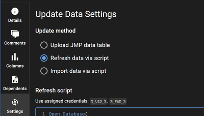

OddsDeer284888
Level III
Re: How to display dynamic Data Filter in JMP Live?
Open Database(
	"DSN=testConnection;",
	"SELECT
            FROM TestTable
            WHERE key IS NOT NULL",
	"Test Table"
this is the example script that the Source generates.
if we wanted to utilize the above script and use variable instead then the correct format to pass the credentials would be like this? Or is their anythign else needs to be added?
::DB_CONNECTION_STRING =
"DSN=testDSN;" ||  // same name as DSN in the credentials
"UID=%_UID_%;" ||
"PWD=%_PWD_%;";
Hello,
You need to ensure that the server where JMP Live resides has the same exact DSN and Driver installed on it that you have setup on your machine. You'll need to work with your internal JMP Live support team to have them install the driver.
HTH,
Bobby
You'll need to pass the DB name, driver, port, server and user credentials (as placeholders).
Here's an example script to query data:
dt = New SQL Query(
       Connection(
			"ODBC:DATABASE=placeholder;
			DRIVER={placeholder};
			PORT=placeholder;
			PWD=%_PWD_%;
			SERVER=placeholder;
			UID=%_UID_%;"
       QueryName( "placeholder" ),
       Select,
       From( Table( "placeholder", Schema( "placeholder" ) ) )
) << Run Foreground;
dt;
