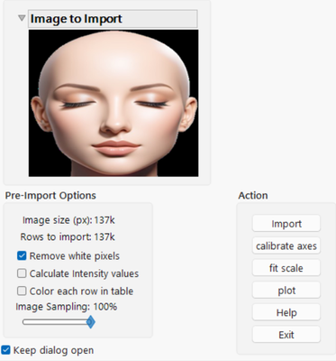

load the image as a data table into JMP, e.g. via Image to Table from the Marketplace:

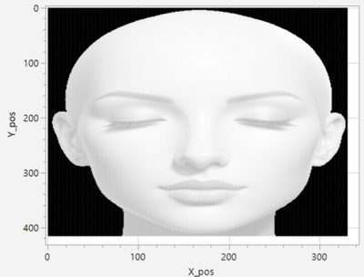

select a point in the background, select matching cells - > create subset
align the x/y scale with the scale of the other data table.
merge the tables - use the "mask" as a mask (e.g. via exclude)

Hello,
Thank you it was exactly what i wanted !
