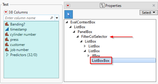

So if I look at the properties of the window, I see the following:
The box that got deleted was actually the very last ListBoxBox. While FilterColSelector has other boxes, when you create it, returned reference is to that last box only.
