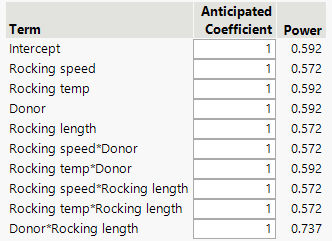

So I have to disallow certain combinations based on equipment capability, BUT it decreases the prediction variance and power significantly. Is there a way get around this? And if I can't, how will I be able to trust the results if power is low and the prediction variance high?

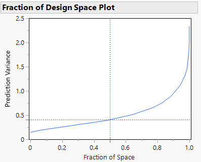

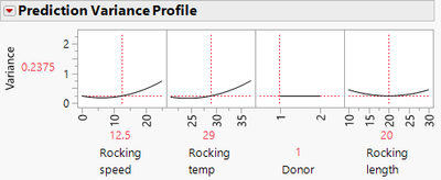

Reading your question and looking at the prediction variance profiler, we can indeed see that your design is not totally balanced, as the predicted relative variance at the lower levels of your factors (rocking temp, rocking speed) seem smaller than the one at the upper levels of your factors, so we can see some constraints. It can be quite difficult to help you without looking at the design itself, but here are some general remarks and advices for your questions related to power and prediction variance:
  • Power is meaningful when you know the relative size of the signal you want to detect and you have good estimates of the experimental and response measurement noise (RMSE) (see answer from @Phil_Kay here : Solved: Should I consider power analysis in DOE? - JMP User Community),
  • Depending on your objective (and design), you may not be interested about significance of terms, but more about predictive precision. In this case, you should look and compare different predicted relative variance (and Fraction of Design Space Plot) for different designs to choose the one that best minimize this relative predicted variance.
  • It may not be very helpful to look at power and/or relative prediction variance, without comparing them with other designs. You can perhaps try to generate several designs with several models and optimality criterion.
    • Optimality criterion: If you want to highlight significant effects, a D-optimal (or A-optimal) design may be appropriate. If you care only about the response prediction, maybe an I-optimal design would better suits your needs.

Limiting the factor exploration space will always come at the expense of power. The way to get around it is to add more runs to the DOE.

Thank you both! The design I chose is just custom DOE with all interactions, except I removed the 4 runs that were not possible and added 2 centerpoints. Where I'm getting stuck is what parameters to do extra runs to decrease prediction variance if I can't test at those parameter extremes.
