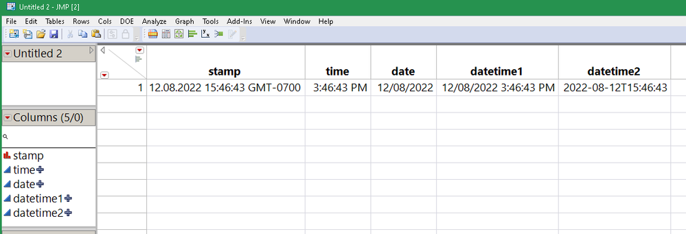

dt = New Table( "Untitled", Add Rows( 1 ), New Column( "stamp", Character, "Nominal", Set Values( {"12.08.2022 15:46:43 GMT-0700"} ) ) );
dt << New Column( "time", Format( "H:m:s" ), formula( Informat( Substr( stamp, 12, 8 ), "h:m:s" ) ) );
dt << New Column( "date", Format( "d/m/y" ), formula( Informat( Substr( stamp, 1, 10 ), "d/m/y" ) ) );
dt << New Column( "datetime1", Format( "d/m/y H:m:s" ), formula( Informat( Substr( stamp, 1, 19 ), "d/m/y H:m:s" ) ) );
dt << New Column( "datetime2", Format( "yyyy-mm-ddThh:mm:ss" ), formula( Informat( Substr( stamp, 1, 19 ), "d/m/y H:m:s" ) ) );
Column formulas extract dates, times, and datetimes.Column formulas extract dates, times, and datetimes.
Usually you'll want a datetime column, not separate date and time columns.
Edit: I'm not sure where the formats are documented; I make a tiny data table, use the column properties to choose/test the format, then save the table script to a script window to grab the format name.
Craige
Craige

Thank you Craige. This worked exactly. You're right, I do want the time and date in one cell now that I think about it.
