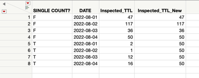

I am trying to adjust total inspection quantity per day based on the "Single Count?" column. Created a new inspection quantity column Inspected_TTL_New. If the input in this column is "F", Inspected_TTL should be same as Inspected_TTL_New. But if it is "T", Inspected_TTL_New column should be the Inspected_TTL quantity for "F" on the same day.

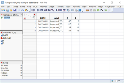

Then you will get a new table like this. And the column F is the data.
Then Join the dt_tran to original dt.

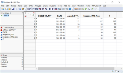

final dt like this one.
Hope this helps.
