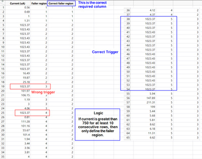

Hi All,
I am looking for formula column where its elements depends upon the  at least 10 consecutive rows of other column full filling a threshold value. Please see the attached image and data. Those also include the required column "Correct failer region".
Any help please.
Thanks, HSS

Re: How to define a new column based on n consecutive rows condition
Data table subscripting is one option.

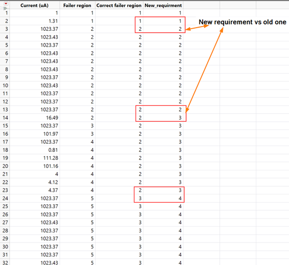

3. In my current problem, I would like to increase the counter by one once the desired region is finished (with minimum 10 entries) -- something like this -
Any help ?
thanks, HSS
There is a mistake in the attached image in previous message. Please ignore the last red rectangle, as by mistake, I have change the counter for old requirement too. That should not be the case.
thanks, HSS

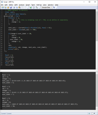

jthi
What I would suggest doing is modifying the script to something like this which will allow you to run it "row by row":
// Names Default To Here(1);
// Clear Log();
dt = Current Data Table();
run_script = Expr(
	If(Row() == 1,
		val = 1; // this is breaking rule of > 750, so we define it separately
		change = 1;
	next_vals = :Current[Row()::Min(Dim()[1], Row() + 9)];
	over_limit = Sum(next_vals >= 750);
	If(change & over_limit >= 10,
		val++;
		change = 0;
	, over_limit < 10,
		change = 1;
	val;
	show(row(), val, change, next_vals, over_limit);
	Write("\!N");
Row() = 1;
run_script;
Row() = 2;
run_script;
Row() = 5;
run_script;
Then you can fairly easily run the script in parts and look at the log to see what happens (you can also run one row at the time if you want to).
Script Window and Embedded Log:
Scripting Index is also helpful in explaining the functions, such as Dim().
If this won't be enough of a help, please comment in this post and tag me, I can try to explain it in more detail.
-Jarmo
@jthi Thanks for explanation.
I run it row by row and got a quite a bit.
Still I have no clue why do we have variable 'change' in the script and what is its purpose ? It is just taking two value, either 1 (as the set value) and 0 whenever we are getting more than 10 entries in a row with satisfying current value. But it does not appear anywhere in new column indexing. But if I am running it without variable 'Change' I do not get correct entries. But I am not able to figure out how and where does it impact our calculation/indexing.
Hello @jthi,
I tried something on my new requirement. It may not be the best solution but it is a work around. And it is very close to the solution you suggested for original problem. Till now it is working fine.
If( Row() == 1, val = 1 );
Next_10_values = Sum( :Current[Index( Row(), Min( Dim()[1], Row() + 9 ) )] >= 750 );
Previous_10_values = Sum( :Current[Index( Row(), Min( Dim()[1], Row() - 9 ) )] >= 750 );
If(
	Next_10_values == 10 & Lag( :Current ) < 750 | Previous_10_values == 9 & :Current < 750 &
	Lag( :Current ) >= 750,
	val = val + 1
val;
Many thanks for your support.
Regards, HSS
