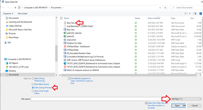

1. Open JMP.
2. Use Windows Explorer to select "All Files(*.*)" then open as "Data Using Preview"  In this example, I'm using a .txt file version of the Big Class dataset available in the JMP sample data directory.

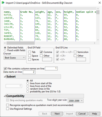

3. Specify delimiters, lines to skip, etc...

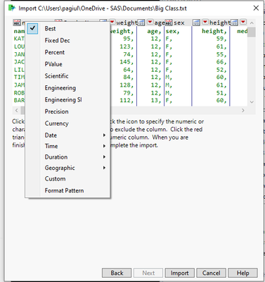

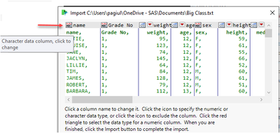

4. Click Next. Click over the Icons to change the data type. Click the red drop down arrows to change the format.

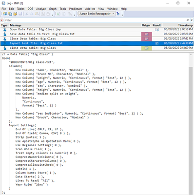

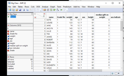

5. Click the "Import" button.  JMP will save a source script to the data table (which is stored in the upper left hand corner of the table next to the green play button):
If you right click to edit the script, it will look something like this:
Open(
