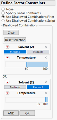

A more practical and flexible way to deal with these differences could be to use the disallowed combinations filter in the Custom Design platform. Here is a small DoE as an example, dealing with 2 factors :
  • A categorical 2-levels factor, the choice of solvent : Methanol or Propanol.
  • A continuous factor, Temperature (°C).
As the boiling point of Methanol is around 65°C and the one of Propanol is around 97°C, I want to define disallowed combinations in my experimental plan : no experiments should be run above 60°C when using Methanol, and no experiments should be run above 95°C when using Propanol. I can define this constraint using "Disallowed Combinations Filter" :
Or using the following script in the "Disallowed Combinations Filter script" :
Solvent == "Methanol" & Temperature >= 60 | Solvent == "Propanol" & Temperature >=

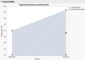

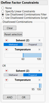

After specifying my model, I can check than my experimental constraint has been considered in my design :
