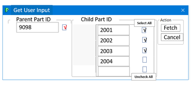

I would like to create a two column user input modal window where the user input goes into the first column (single input box) for a "parent part ID", based on which adjacent second column window entries (child part IDs) get populated.
  • The entries in the second column come from a database query (for which I already have a script). A "parent part ID" can have one or more than one "child part IDs"
  • This query script needs to run upon a checkbox being checked adjacent to the parent part ID input box after the input.
  • Once one or more than one child part IDs (as the case may be) are selected in the second column (again using checkbox), press of the OK button at the bottom of the modal window is to make the selected entries in second column available (as a list) for a follow on script to use.
  • A select all option for the entries in the second column would be an added advantage.
I would appreciate if I can get some ideas on how to proceed with this in JSL?

@jthi Please see attached. User enters e.g. 9098 and checks the box (red tick, does not need to red colour btw) under Parent Part ID. Checking this box runs a script in the background which generates a single column data table or a list (I have this script so can do either as needed). The row values of this single column table or list values populate the rows on the right side of the user input window, under Child Part ID. User then selects the Chart Part IDs as desired using the check box ("select all" and "uncheck all" options would be great to have).
Upon pressing Fetch, the Parent Part ID and Child Part IDs are to be made available as two separate lists  for a follow on script to use.
Hope I have been able to explain clearly enough.

Ok. Few suggestions I would replace check boxes with buttons. For Parent Part ID it could be something like "Get Child Part IDs" and for Child Part ID buttons for "Select All" an "Unselect All". User can perform their selections in the list box.
