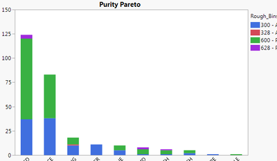

How to create a stacked pareto chart?
Example:
Series 1: Numeric data (Quantity)
Series 2: Categorical (Supplier)
Series 3: Categorical (Design)
Would like to have a pareto of Qty(Y axis)  by supplier (X axis) with "design" as stacked column. I have JMP9.

Re: How to create a stacked pareto chart?
Can also  be done with Graph Builder :
I too have this same question.  Doesn't look like it's possible.
I have found a work around by running a summary table and then using graph builder to make the display come out correct, but it would be way nicer if I could easily have a second category in the pareto chart function.
You can use the Chart platform and select the Stack Bars option :
