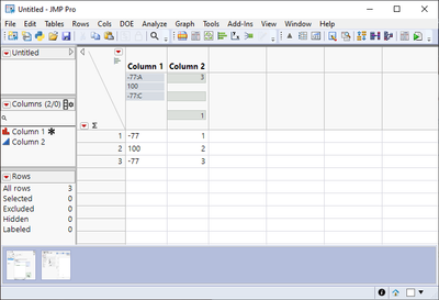

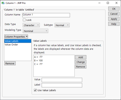

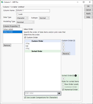

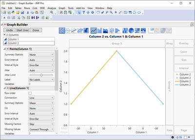

jthi
Re: How to create a "revolving" x-axis in JMP?
You can at least use Value Labels and Value Order column properties to create something like this
Most likely there are also other ways of doing something like this (having two x-axis for example)
but I'm not familiar with the data you have or what you are trying to visualize
-Jarmo
hogi
Level XIII
two x axes (one reverse one) - good idea : )
