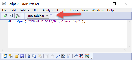

How to create a new script editor with a toolbar in JSL and paste the content of the paste board into the script editor?
txt=Get Clipboard();
New Window( "Example", sb = Script Box( txt ) );
with a toolbar
Thanks!

Also I would suggest using script type new window if possible
Names Default To Here(1);
script = Get Clipboard();
ex = New Window("Script example", <<Type("Script"), script);
and if you wish to have the text in current script editor, I have to ask, why wouldn't you just paste it there? This can help with scripting the script editor if needed Scripting Guide > Display Trees > Scripting the Script Editor
