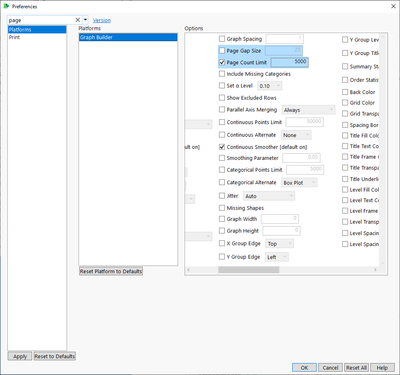

I am trying to display and/or export close to 900 graphs from a dataset using Graph Builder using JMP Pro 17.0.0 into a PowerPoint or pdf format. However, it seems like 200 graphs is the maximum JMP will display or export. Am I missing something to display/export them all or is there a preference I can toggle to allow more to be displayed/exported? Thanks!

Changing this preference might help
