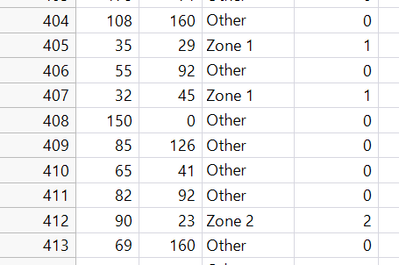

The result value is using the 0 or 1 truth value in cmatxy1,2 to build the 0, 1, or 2 value for other, zone1, zone2. You could probably collapse some of the matrix statements to make it still faster if that is important.
Craige
Re: Quickest way to iterate over a data table
Thank you very much, it is mush faster now !
