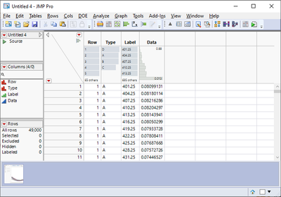

1. Create new column which indicates the row number

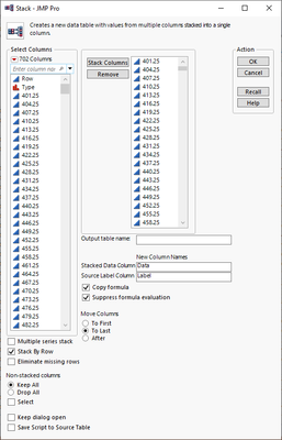

2. stack your numerical columns

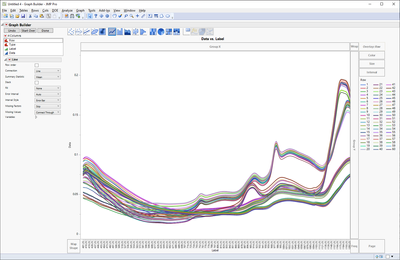

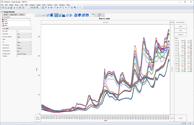

3. Create graph builder with your new data
using row as overlay and label as x-axis (change data/modeling types as you want them to be)
scaled to quite similar as your excel image
