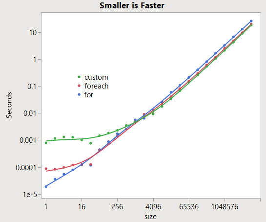

Craige_Hales
Re: How to convert a numeric list into a character one?
Extending Jeff's answer
Different overheads hurt for small sizes and help for large sizes.Different overheads hurt for small sizes and help for large sizes.

Craige

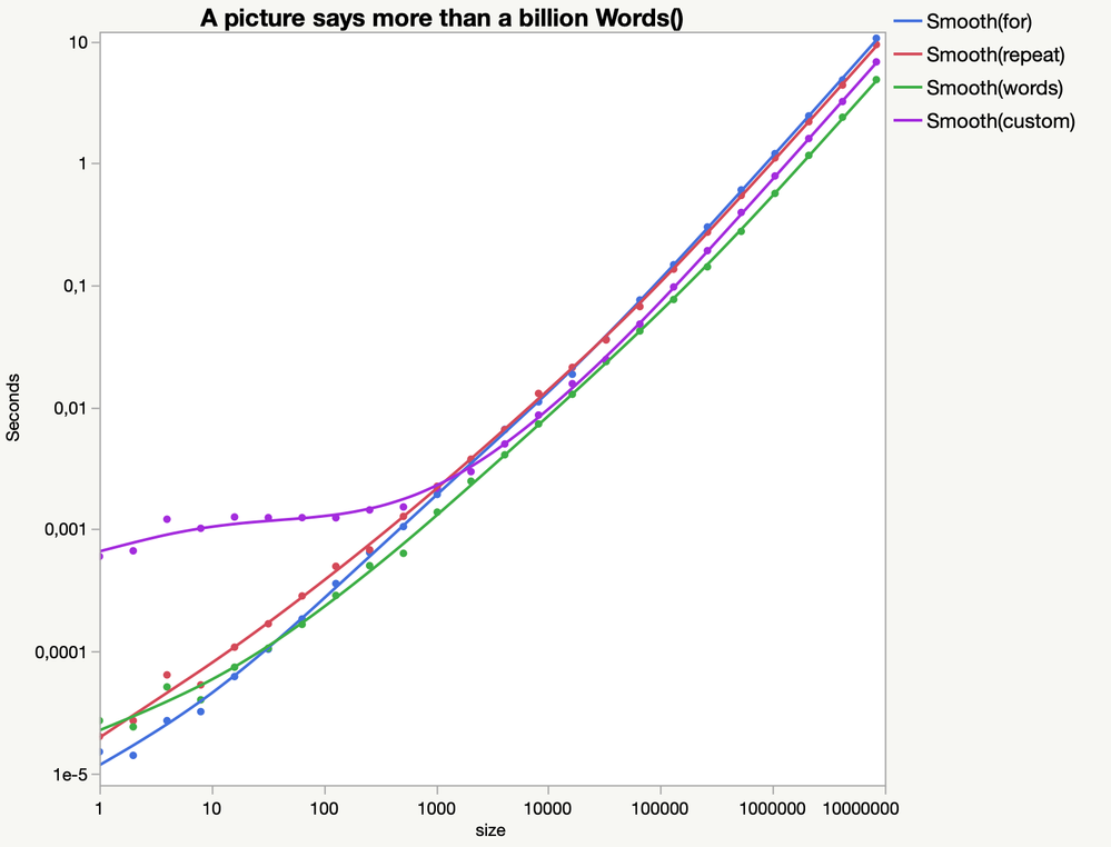

Nice illustration of the size-dependent performance of the different functions. I'm still using JMP 15 and can't use For Each() yet, but to extend Jeff's timing exercise further I toss in two more functions that give the same result.
Repeat(k = 0; {k++; Char( theList[k] )}, listsize);
Words( Substr( Char( theList ), 2, Length( Char( thelist ) ) - 2 ), ", " );
The For loop, which is the fastest for small lists, is surpassed by Words at size>50, by the data-table-detour function at size>1000 and by Repeat at size>30000.
I was a little surprised to see that Words remained the fastest for size>50, about twice as fast at millions of "words".
