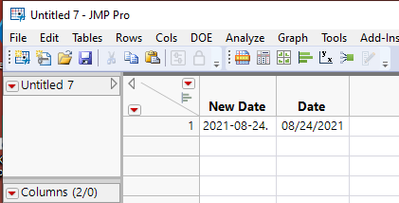

Re: How to convert a numeric column to a date column correctly?
Here is an example showing you how to do your conversion
  1. Open the data table with your character date values
  2. Create a new column and give it the name Date

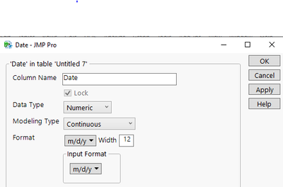

  3. Open the Col Info dialog and set the format to "m/d/y"                                                       txnelson_0-1634441532195.png

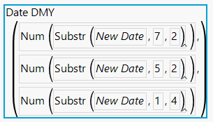

  4. Open the Formula Editor for the new column and enter
    Date MDY(
    	Num( Substr( :New Date, 6, 2 ) ),
    	Num( Substr( :New Date, 9, 2 ) ),
    	Num( Substr( :New Date, 1, 4 ) )
    Change "New Date" to the name of the column that has the character version of the date
  5. The new column will then display the new numeric version of your date                           txnelson_1-1634441841000.png

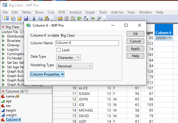

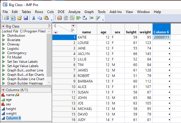

Here is an example where the column values(in this case only one row is populated) are numeric and in the structure you have indicated.
To change this to a proper JMP date/time column here is how I would do it.
First open the Column Info dialog for the column in question
In able for JMP to recognize this using an Informat which will convert the 20001101 to a Date/Time value, the input column needs to be character, so change the Data Type to Character and click on Apply

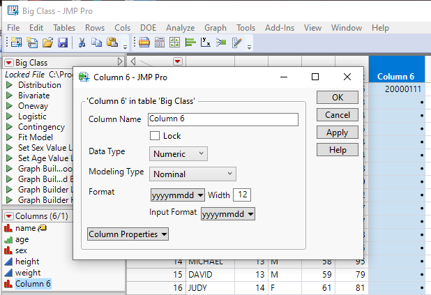

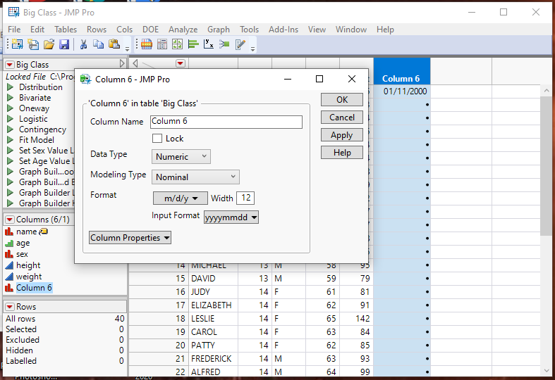

Now go back to the open Col Info dialog box, and change the Data Type to Numeric, and select the Format, "yyyymmdd" from the list of formats. Once again, click on Apply
Note in the above image that the displayed value remains the same.  This is because the display format is "yyyymmdd".  Also notice the column has been changed back to Numeric.

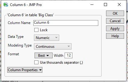

To validate that it is a true JMP Date/Time column, you can change the display format to a different Date format.  So go back to the Col Info dialog box, and select a different Date format.  In my example, the "m/d/y" format is selected.  Then click on apply
As can be seen, the correct Date is displayed as 01/11/2000.
Now just click on OK, and the column is converted as you want.
