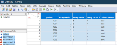

Hi @VBIR ,
As @txnelson mentioned, to get the table to look exactly as you shown, you would have to do some scripting or multiple interactive steps. However, JMP tables really are not designed to display data in that way. They are data tables, not spreadsheets, so the simple join would look like this from a JMP data table point of view
This is because JMP tables are used for analytical and graphing purposes, where as spreadsheets are for making numerical summaries that are easier to read. In the clinical trial world, data is typically stored in the fashion shown in the image, but might be displayed more like what you have shown.
So that leads to the next question, what is your goal with displaying the joined data in the fashion that you have given us? Is it for reporting purposes or are you planning to do some additional graphing or analysis with the result?
