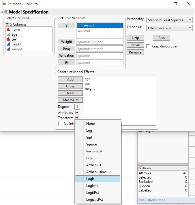

You might also try another approach: use the logit transform on the response. Complete the Fit Model dialog as usual. Then select the Y column, click the red triangle next to Transform, and select Logit.
NOTE: Don't try this example, the response weight does not have the appropriate range of 0-1.
