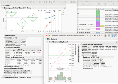

I have 3 different groups and I'm aiming to compare them to see if there are any statistically significant differences. However, my sample sizes are quite small: Group 1 has 3 samples, Group 2 has 2 samples, and Group 3 has 3 samples. Due to this small sample size, I'm unable to test for normality.
To analyze the data, I conducted a Kruskal-Wallis test followed by a Steel-Dwass test (as a post-hoc analysis). I've attached a screenshot of the output for one of the variables, but I have similar results for other variables as well.

Honestly, I don't see what a statistical test could add to the graph.  Perhaps someone with a better statistical background can articulate a reason, but I wouldn't care whether the p value was 0.03 or 0.1 or 0.4 in this case.  The graph suggests that the middle group is highest with a bit weaker "evidence" that the third group is higher than the first.  It is a good start and I would view it as an exploratory analysis - so no p value is needed.  I don't think the p value adds anything to what the graph is showing.  You need a larger sample size, and these results suggest it is worth pursuing that, and if it is possible designing an appropriate experiment based on what you are seeing from these preliminary results.

You are probably ok to use a traditional ANOVA analysis in this situation.  The non-parametric tests don't address small samples sizes, they just assume a different underlying statistical model (or make less assumptions about the underlying statistical model.
To determine the p-value for a statistical test requires knowing the expected distribution of that test statistic when the null hypothesis is true.  For larger sample sizes, those distributions can be approximated by well know distributions, but for smaller samples sizes, it typically requires an enumeration or statistical simulation to determine the percentile of the distribution.  There are many places you can find the small sample size critical values for the Wilcoxon / Kruskal-Wallace test, for instance https://onlinepubs.trb.org/onlinepubs/nchrp/cd-22/manual/v2appendixc.pdf (see table C-7).
The Steel-Dwass multiple comparisons test is also non-parametric, and because it is controlling the overall type I error rate,   it is hard to show statistical significance for each pair.  In your case, the sample sizes may not allow calculating confidence intervals.

You can still do the ANOVA, save the residuals from the ANOVA (it will save them to a column named "<Response> Centered by <Group>"model and make a histogram, QQ plot, ...   This is me speaking as a statistician...don't make so much of normality.  It will be ok.  The only reason it might not if is you have a very large outlier or you knew that the the process that produces the results will have a response distribution that is markedly non-normal.  ANOVA is fairly robust to small to moderate departures from normality.

@SamGardner I see you did a normality test by combining all the data points so you ended up with 9 data points, I thought you were supposed to do the test for each group

Hi @ELH   The residuals should be normally distributed (residuals are the data “corrected”, via subtracting group mean, for differences between groups so you can assess normality of residuals wrt to all observations). But as @SamGardner  said, a small departure from normality is nothing to worry about. Constant variance is, IMHO, more important than normality; informally, this means the spread of data within each group should be about the same for each group. So, in general, if your residual plot (residuals vs. predicted) looks random with no pattern to speak of, then keep calm and carry on.
