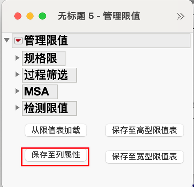

Hi, JMPer
Currently, I used below jsl.
obj = dt <<
	Manage Limits(
	Process Variables(:FAI_1, :FAI_2, :FAI_3, :FAI_4, :FAI_5
	Load From Limits Table( "LIMIT.jmp" ),
	SendToReport( Dispatch( {}, "Spec Limits", OutlineBox, {Close( 1 )} ) ),
obj << Show Limits All;
obj << Save Spec Limits as Column Properties;
It need to manual click Save Spec Limits as Column Properties of manage spec window. Then the spec limits will effective on graph build.
How to auto Save Spec Limits as Column Properties of manage spec window?
txnelson
Re: How to auto Save Spec Limits as Column Properties of manage spec window
Here is an example of using Manage Limits where the limits are applied without having to do any manual clicking
Names Default To Here( 1 );
dtLimits = New Table( "Cities Limits",
	Add Rows( 4 ),
	New Column( "Process", Character, Set Values( {"OZONE", "CO", "SO2", "NO"} ) ),
	New Column( "LSL", Numeric, Set Values( [0, 0, 0, 0] ) ),
	New Column( "Target", Numeric, Set Values( [0.2, 15, 0.05, 0.035] ) ),
	New Column( "USL", Numeric, Set Values( [0.4, 30, 0.1, 0.07] ) ),
	Set Label Columns( :Process )
dt = Open( "$SAMPLE_DATA/Cities.jmp" );
obj = dt << Manage Limits(
	Process Variables( :OZONE, :CO, :SO2, :NO ),
	Load From Limits Table( dtLimits )
obj << Save to Column Properties;
obj << close window;
