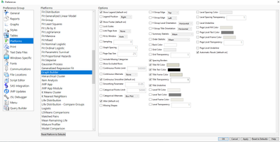

I'd suggest you go to file > preferences > platform > graph builder. Then adjust your settings. Tick the boxes you're interested to change. You may reset them back to default if there's anything abnormal. Feel free to let me know how it went

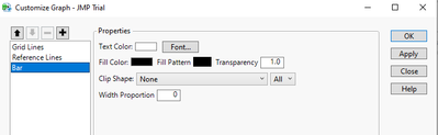

Right click on the bar, select customize, select bar and in the properties options, the text color should do the trick
