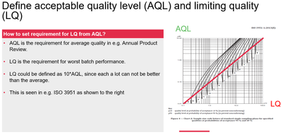

The situation is that I have a team of vision specialist but they do not know when they have achieved their goals which have a attribute respons (not good/good). I want to use LQ level due to we are doing validation which should present the worst batch where AQL is more average batch performance. But I want to first find my AQL level to find my LQ level.

Hi @qLienceStats : Not sure exactly what you are asking. An acceptable AQL and LQ are not "derived". i.e., whether or not the AQL and LQ of a given sampling plan are acceptable or not is not something to be calculated. Example: Say a sampling plan has an AQL of 0.72% and an LQ of 7.6%. Yes, those numbers can be derived...but are they acceptable?  That is not a statistical question. Or am I misunderstanding your question?

Hi @qLienceStats : I'm very aware of the statistical details of OC curves, AQL/LQ, etc. However, I'm afraid I can't answer the question of "what is a suitable AQL level" (or LQ level). That strikes me as non-statistical question and outside my area of expertise. i.e., what is suitable for one product/process may not be suitable for another.
