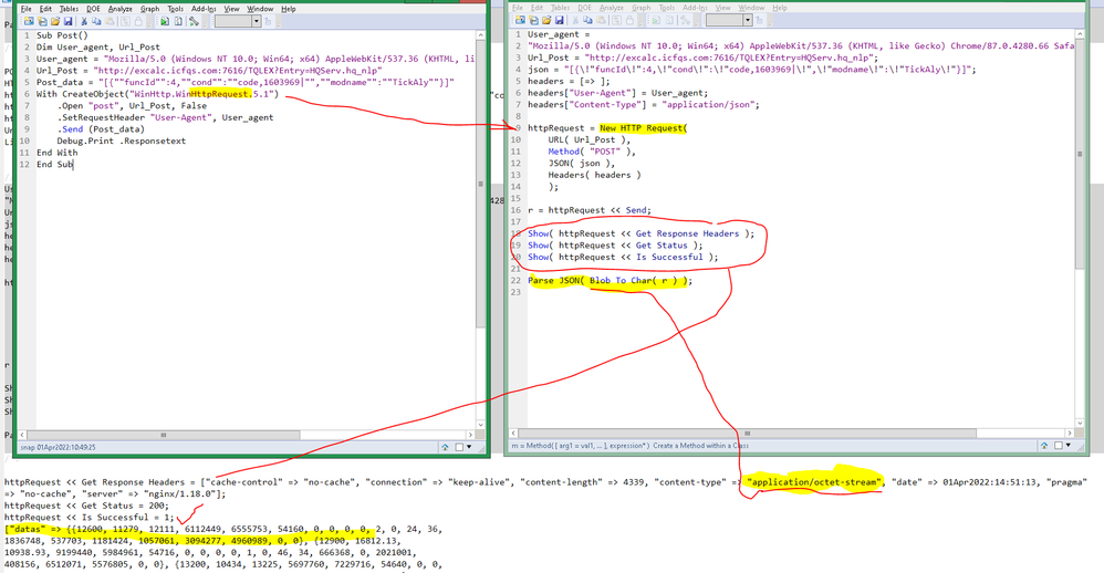

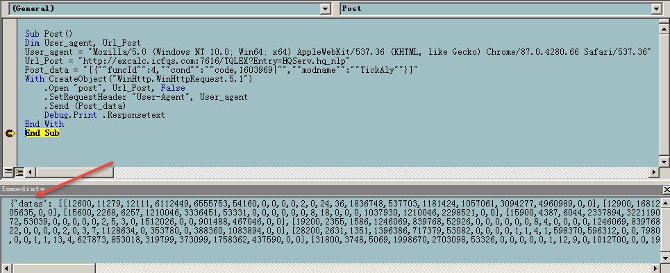

The VBA can download data from this website.But I don't know how to change it to JSL to make it work.
Thank you very much!
Sub Post()
Dim User_agent, Url_Post
User_agent = "Mozilla/5.0 (Windows NT 10.0; Win64; x64) AppleWebKit/537.36 (KHTML, like Gecko) Chrome/87.0.4280.66 Safari/537.36"
Url_Post = "http://excalc.icfqs.com:7616/TQLEX?Entry=HQServ.hq_nlp"
Post_data = "[{""funcId"":4,""cond"":""code,1603969|"",""modname"":""TickAly""}]"
With CreateObject("WinHttp.WinHttpRequest.5.1")
    .Open "post", Url_Post, False
    .SetRequestHeader "User-Agent", User_agent
    .Send (Post_data)
    Debug.Print .Responsetext
End With
End Sub

Use JMP's http request, just like VB.
The octet stream means you need blobToChar conversion.The octet stream means you need blobToChar conversion.

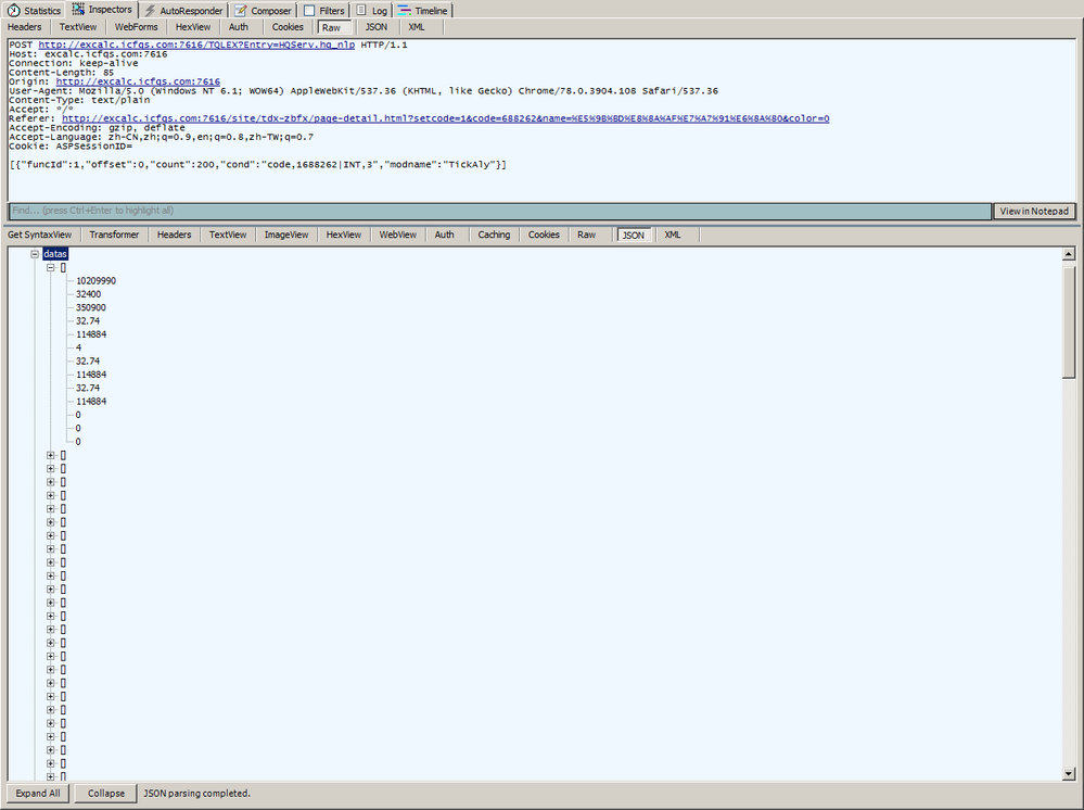

POST:
http://excalc.icfqs.com:7616/TQLEX?Entry=HQServ.hq_nlp HTTP/1.1
Host: excalc.icfqs.com:7616
Proxy-Connection: keep-alive
Content-Length: 85
Origin: http://excalc.icfqs.com:7616
User-Agent: Mozilla/5.0 (Windows NT 6.1; WOW64) AppleWebKit/537.36 (KHTML, like Gecko) Chrome/78.0.3904.108 Safari/537.36
Content-Type: text/plain
Accept: */*
Referer: http://excalc.icfqs.com:7616/site/tdx-zbfx/page-detail.html?setcode=1&code=688262&name=%E5%9B%BD%E8%8A%AF%E7%A7%91%E6%8A%80&color=0
Accept-Encoding: gzip, deflate
Accept-Language: zh-CN,zh;q=0.9,en;q=0.8,zh-TW;q=0.7
Cookie: ASPSessionID=
[{"funcId":1,"offset":0,"count":200,"cond":"code,1688262|INT,3","modname":"TickAly"}]

VBA code, I just don't know how to change to JSL.
Experts are invited to guide.Thank you very much!
