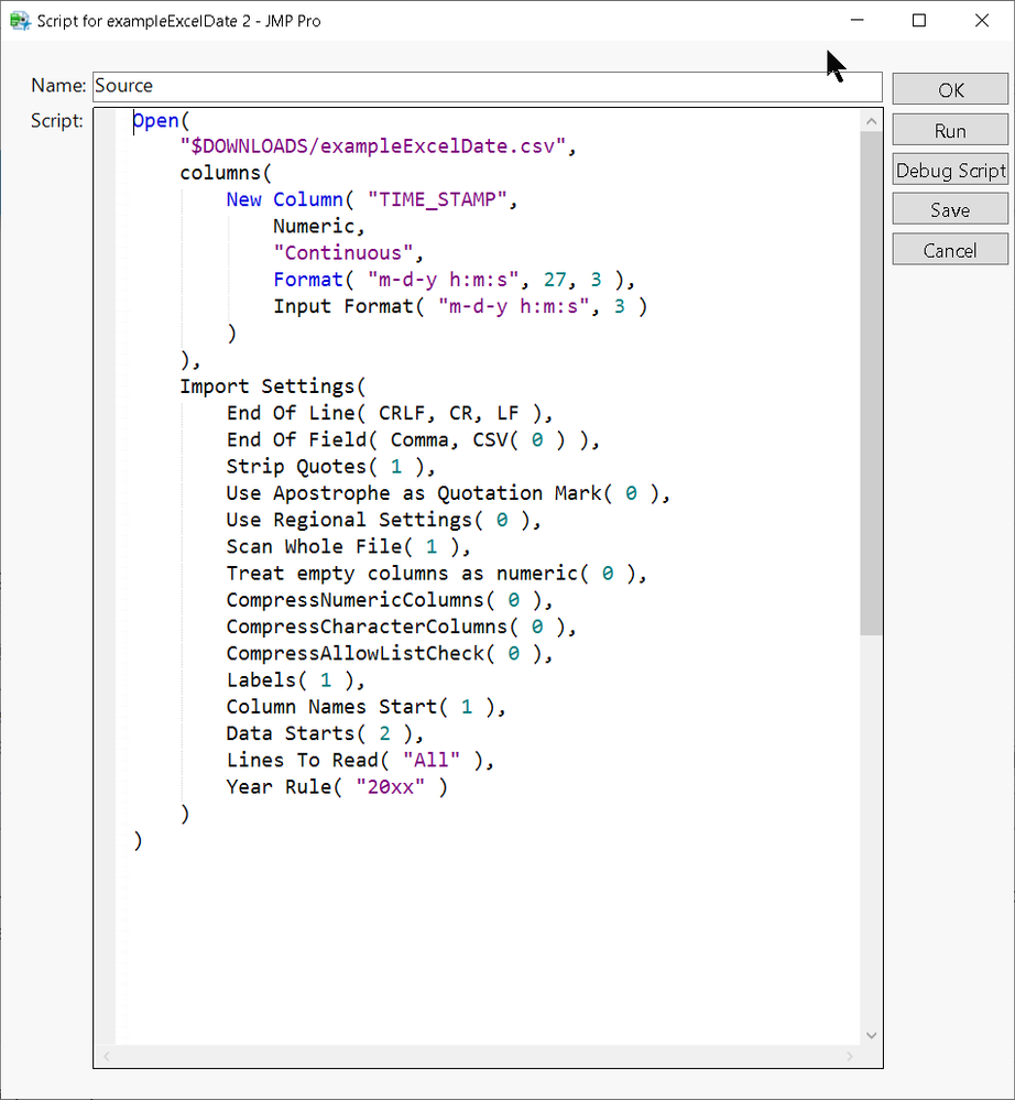

Right-clicking on the SOURCE script in the upper left of the table and selecting "Edit" will show you a script you can run to bypass the wizard in the future, making it easy for you to recreate this table with the most recent version of the .csv file, whenever you wish.
