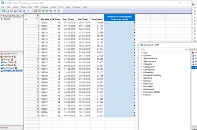

Hi community
I need your help and advise once again. As a new user I'm struggling to learn.
I have a data table with start date and end date. I would like to calculate the number of working days in between the start and end date ?? How is the best way to do that in JMP ?? My idea is to add a column and make a formula, e.g. Date difference?? But i'm not sure what would be the better option.
please see attached example
Thanks
Martin

Hi @Martinej ,
I wrote an add-in awhile back that calculates the number of working days between two date columns. Holidays and any other specific days you want to exclude are addressed by maintaining a Holiday List.jmp file stored in your add-in directory. Note: this file could be any document (Excel, .txt, .csv, etc) maintained in any location accessible by the JMP user's machine, however, this would require a minor tweak to the underlying JSL to provide the file location. Otherwise, I believe it addresses your requested need as-is. Follow the instructions for downloading, installing, and editing the Holiday List file:NETWORKDAYS Function

Hi @Martinej ,

Martinej
Level II
Re: How to calculate number of working days?
Hi Jerry
this was really helpfull. I made my own list and now it showed what i would like.
Thanks
