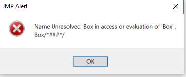

I understand the need to add the list variable & the typo. however when i updated the code- & ran it , i get this error. My Column names are "Box 1" . "Box 2" etc.
However i did try changing the column names to Box1 , Box 2 and Box3 etc , and got the same error. any suggestions?

I assumed that Box was referencing a memory variable called Box which is a list, and contains several elements, each one being the name of a variable. If this isn't it, what is Box?

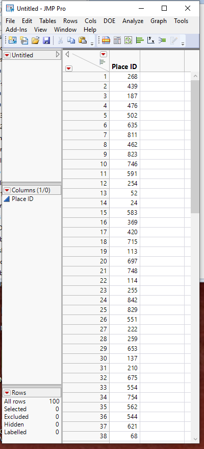

I created a data table with a column called Place ID.  I populated it with 100 random values that ranged from 1 to 850.
I then ran the section of code that various  Box and ActualLoc and it created a data table that looks like this:
I do not see the intent with performing these operations.
It appears to me(I could easily be wrong) that you do not have the understanding of some elements that you are using.  Within your first For() loop, you create the same columns of Scenario, Box and ActualLoc 5 times.  And since JMP will not allow a column have the same name, when you create Scenario, Box and ActualLoc during the first loop, those are the actual names it will use.  However, on loop 2, JMP will force the names to Scenario 2, Box 2 and ActualLoc 2.  Loops 3,4,and 5 repeat this behavior.  The formulas used are also a little confusing.  You are repeatedly using the specification of (:Place ID - i).  Since this is being used in a formula, which means that the formula will be applied to each row in the data table, and  the result of this calculation will be the value of the variable Place ID for the given row (i.e row 1 in my data table has the value 268) and it will subtract off the current value of i, which has the value of 1 on the first loop, 2 on the second loop, etc.  Thus the for row 1, the values range from 267 to 263.  I suspect you may be thinking that :Place ID -1 is referencing the column that comes before :Place ID.
