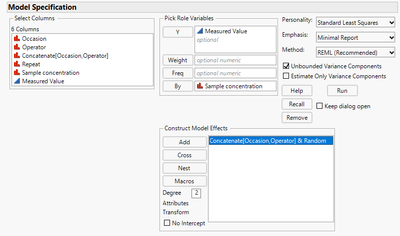

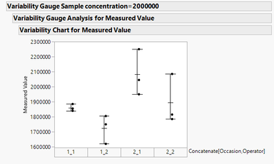

I would suggest to combine (concatenate) Occasion and Operator into one column describing each setup of the method. Here is what your data looks like for the highest sample concentration.

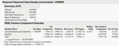

In this way you can estimate variation between setups, and variation between Repeats within setup. I would do this using Analyze -> Fit Model, where Setup (concatenated Occasion and Operator) is modelled as a Random effect.
In the output from this analysis you can find the SD (Sqrt Variance Component) for between setups, within a setup, and the total (sum) of these. The 95% confidence intervals associated with each of these SDs can be calculated as the square root of 95%Lower and 95%Upper. In ICH Q2 terms Total variation is Intermediate precision, and residual is Repeatability.
