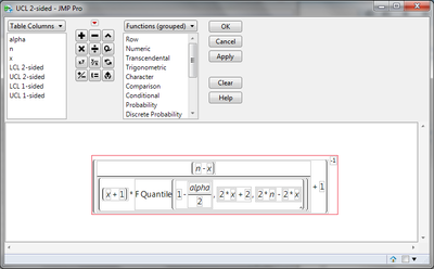

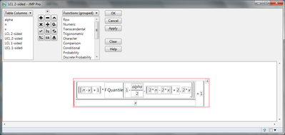

You can build the formulas in JMP for upper and lower confidence limits (2-sided or 1-sided) following Hahn and Meeker's book Statistical Intervals sections 6.2.2 and 6.2.5. Very useful book.
Lower 2-sided 100(1-alpha)% confidence limit for p = x/n:
Upper 2-sided 100(1-alpha)% confidence limit for p = x/n:
For 1-sided limits replace alpha/2 by alpha.

Note that the solution already covered uses the Fisher-Snedecor distribution (aka F-distribution), which is perfectly appropriate and highly accurate to approximate the binomial.  Here is an additional publication reference which details the calculations for Clopper-Pearson and includes another method (using the Beta Equation, from p. 38 of Krishnamoorthy, K., Handbook of statistical distributions with applications, (c) 2006 Chapman& Hall, CRC Press) which works equally well.
LCL =
UCL =
where C = confidence desired or required, k = number observed events, and N = total number of possible events.
