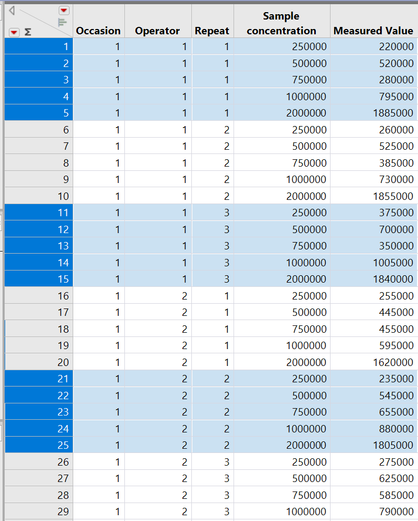

I am trying to perform variance component analysis (using JMP 18.0.2) to calculate %CV values for ICH precision data, more specifically to compute (a) Repeatability, (b) Intermediate precision and (c) reproducibility.
The study was performed by 2 operators, measuring 3 replicates on 2 different occasions, across 5 different sample concentration.
Would really appreciate if someone can help me to do the proper analysis to get the ICH precision data. I have tried using Variability/Attribute Gauge chart and performed nested analysis using REML as well as Bayesian analysis. Which of these should i use for the analysis? I also realize the outcomes are impacted by the model type (nested or crossed). SHould i use REML or Bayesian? Should i use nested or crossed? Should Operator be nested under occasion or Occasion nested under operator?

I'm wondering regarding the structure of your dataset. The rows are not uniquely identified by combinations of Occasion, Operator and Repeat. In other words, how can Operator #1 measure the same Repeat 5 times at a single Occasion?

Hi @Ressel : Thanks for your comments. I am trying to establish precision for repeatability, intermediate precision and reproducibility for an assay method. (Based on ICHQ2 recommendation, for repeatability assessment one would need a minimum of nine determinations covering reportable range for the procedure (e.g. 3 concentrations/ 3 replicates each). Concentration range for my assay is 2.5e5 to 2e6 (sample concentrations). These samples were prepared in triplicates (repeats). There were 2 operators that were taking 3 measurements (triplicates) for each of these sample concentrations. The same procedure was repeated on a second occasion. Hence 2 occasions, 2 operators, 3 repeats for 5 sample concentrations that cover the range of the analytical assay.
The question is, how do i get precision CVs for repeatability (repeat measurements across the 5 different concentrations), intermediate precision (across operators and occasions) and reproducibility (across operators).

I would suggest to combine (concatenate) Occasion and Operator into one column describing each setup of the method. Here is what your data looks like for the highest sample concentration.
In this way you can estimate variation between setups, and variation between Repeats within setup. I would do this using Analyze -> Fit Model, where Setup (concatenated Occasion and Operator) is modelled as a Random effect.
In the output from this analysis you can find the SD (Sqrt Variance Component) for between setups, within a setup, and the total (sum) of these. The 95% confidence intervals associated with each of these SDs can be calculated as the square root of 95%Lower and 95%Upper. In ICH Q2 terms Total variation is Intermediate precision, and residual is Repeatability.
