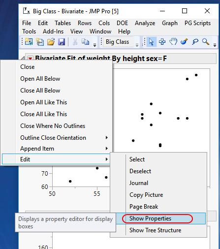

Re: How to apply display options to multiple results(figures)
Another way that you can edit multiple objects is through the property editor.  Right-click on the outline disclosure icon to bring up the property panel:

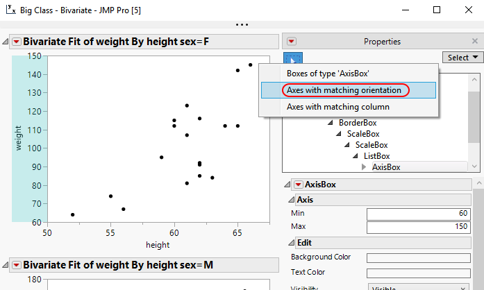

Select one of the axes, and then use the "Select" menu to select all matching axes either by orientation or by column:

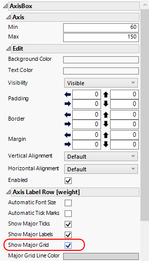

In the property panel below, you can change any property and have it apply to all selected objects:
Note that behaviors will vary with JMP version - the property panel has been around for several releases, but multi-select for editing multiple objects was added in JMP 14, and multi-select for editing the Axis Label Row sub-objects is new in JMP 15.
