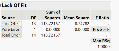

Upon modeling the data after the augmentation i get a significant lack of fit.

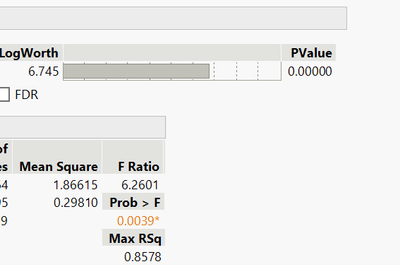

Using the recommended transformation based on the distribution still gives me a significant lack of fit:
