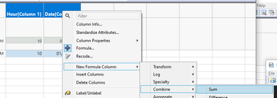

I would create new column which removes minutes and seconds from your date time column. You can create it with quick formulas JMP provides you with but it will require few of them. First you can create Date column
Then create Hour column
And combine these
Next open the created column, change format and modify the formula by multiplying the hour by In Hours(1) (same as 60*60 which is seconds in hours, this is basically how JMP manages time). Final formula would look something like this
In Hours(:"Hour[Column 1]"n) + :"Date[Column 1]"n

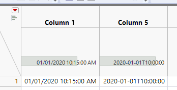

I just wondered about:
with date & time rounded to minutes, there is no issue with missing.
the explanation:
...no  Date Increment()
So, another approach to round to hours:
