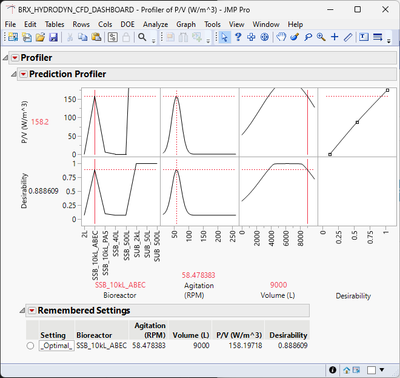

Hello all, I am trying to write a function that tries to hit a user-specified target value in a piece of equipment. The arguments supplied are the name of the target metric that needs to be matched, the value that needs to be matched, name of the equipment and weight of the targeted equipment.
I hope to do this by setting desirability curves using response limits and match target. I tested that the code works when I specify the column and outside of the function as a standalone code snippet. Now that I'm trying to wrap this in a function, the specific part of the code that sets the response limits, doesn't work. Can someone help me identify what I'm doing wrong? Thank you!
The graphical output I'm getting is as follows. The required response metric, factor values and the locks work great but the desirability curve is not changing.

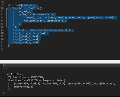

jthi
Re: Request help with setting and maximizing desirability within a function.
Not sure how you would use response limits in this way, separate from Profiler as documentation is lacking and those chosen syntax is in my opinion quite bad... I know you can build the whole Profiler expression and include the response limits to that. Other option would be to utilize response limit column property but I think these have to be set before running Profiler. Looking at your function building it into the Profiler should be fine, this post does provide the basic idea JSL to fit model, maximize desirability, and extract results with user-selectable columns
Names Default To Here(1);
dt = Open("$SAMPLE_DATA/Tiretread.jmp");
lval = 150;
mval = 200;
uval = 300;
col = "Pred Formula ABRASION";
pf = Eval(Substitute(
	Expr(dt << Profiler(
		Y(_col_),
		_colw_ << Response Limits(
			{Lower(_lval_, 0.9819), Middle(_mval_, 0.5), Upper(_uval_, 0.066),
			Goal(Maximize), Importance(1)}
	Expr(_col_), Name Expr(As Column(dt, col)),
	Expr(_colw_), Parse(col),
	Expr(_lval_), lval,
	Expr(_mval_), mval,
	Expr(_uval_), uval
You can check the expression which is being used by just running the Substitute part without Eval
-Jarmo

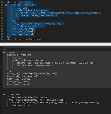

jthi
Response limits are not really being sent to a column but to a JMP name. That is why I use Parse() and not Column()/AsColumn(). No idea why it is implemented like that.
In your case because your column name requires special syntax (""n) try using As Name() instead of Parse().
Column(dt, "Pred Formula ABRASION") << Set Name("Pred Formula ABRASION/123-");
lval = 120;
mval = 150;
uval = 190;
col = "Pred Formula ABRASION/123-";
		Y(_col_),
	Expr(_colw_), As Name(col),
	Expr(_lval_), lval,
	Expr(_mval_), mval,
	Expr(_uval_), uval
pf << Desirability Functions(1);
I suggest checking the expression you are building, with Substitute and EvalExpr it is quite easy by just running that part highlighted
I will also start using that as that is much more robust and most likely the correct way to go with something like this.
-Jarmo

jthi
lval = 120;
mval = 150;
uval = 190;
		Y(_col_),
	Expr(_lval_), lval,
	Expr(_mval_), mval,
	Expr(_uval_), uval
-Jarmo
DeepMink727
Level II
Hi Jarmo,
That worked perfectly! Changing Parse() to As Name() fixed everything and now correctly assigns the name string stored in the variable as the column to which the Response Limits must be passed to.
Thank you again for your help!
