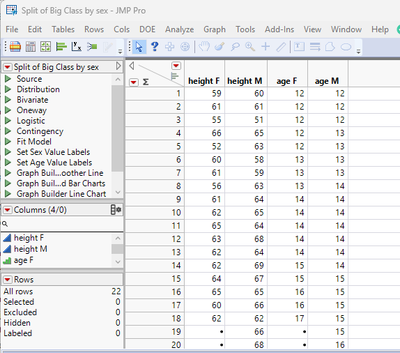

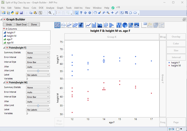

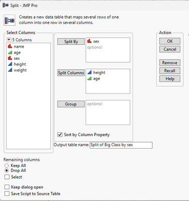

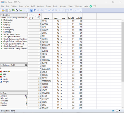

An example:
Big Class data table
Tables=>Split
The split table
Graph Builder
Drag Height F to the Y drop area
Drag Height M to the Y drop area, but at the bottom of the Y axis area
Drag the Age column to the X drop area
The 2 Y axes are independently settable
