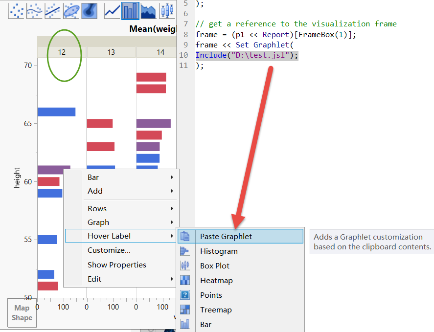

I will simply imitate,
Take this
Include("D:\test.jsl");
Copy and paste it into the script of the hover TAB.
The image also pops up, but the correct name parameters are not correctly obtained.
Still don't know how to fix it.
Hope to get expert help.Thank you very much!

I just paste in age =12, other ages don't work.How can all ages work?
Thanks!
jthi
回复: How to add JSL to "Big Class.jmp" graphics using Hover Labels?
Hold Ctrl when you right click and paste the graphlet. Each of the frameboxes have separate graphlets

lala
Level IX
Thanks Experts!
I follow the sample files in the index combined with your tips.This can automatically implement each age plus script.
But the question that remains to be solved is how to use this test.jsl to automatically get the name parameters of the various locations to which the cursor is pointing?
