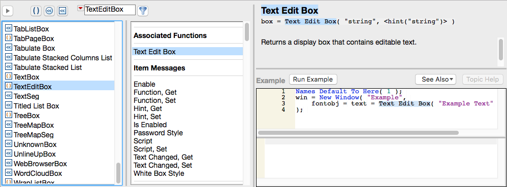

Once you have the type of display box you are interested in (for example, a 'text edit box ()'), you can search for that in the scripting index (see Jim's post above). Then you will see what messages are relevant and (usually) an example.

The elements are referenced by either their absolute position from the entry into the report structure, or by a relative reference from a fixed, unique point within the report structure.
["Graph Builder"][TextEditBox(1)]<<set text("new title");
This example points to the Graph Builder outline box and then references the first text edit box under the outline box.
The simplicity of the Graph Builder output only has the one outline box, but in other cases there are multiple outline boxes that a reference to a particular on would take the reference off on a different path.
