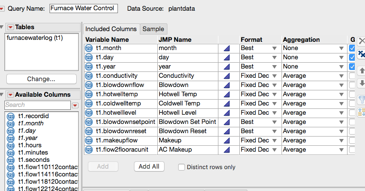

Here is the current sql

The original data is coming in from an SQL server.
The date is recieved in three seperate colums.
I would like to add a date column in this querry from the available columns.
Screen Shot 2016-12-12 at 10.24.25 AM.pngScreen Shot 2016-12-12 at 10.23.58 AM.png

mallen810
Level III
Re: changing date format in a query
Thanks guys for all your responses.
Eric, just added the post query script and it worked perfect.
Thanks again.
