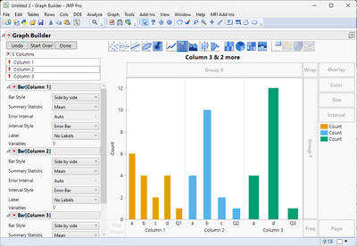

I’m trying to visualize survey data in Graph Builder where the categorical column contains multiple selected options separated by ';', but I can’t figure out how to make JMP treat these as multiple responses.
How can I properly visualize this kind of data?

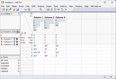

Example:
Q1 Q2 Q3
a;b a;c d
a;b;c;d b a;d
a;d a;b d

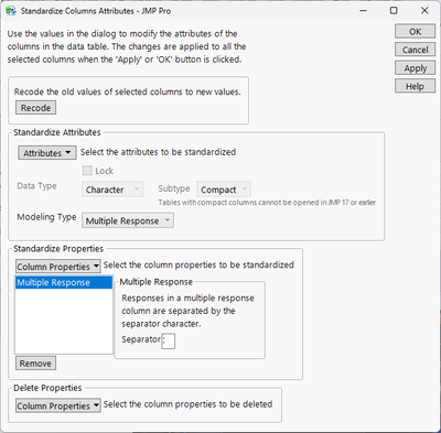

Have you tried setting those columns to multiple response columns WITH a separator (column property)?
