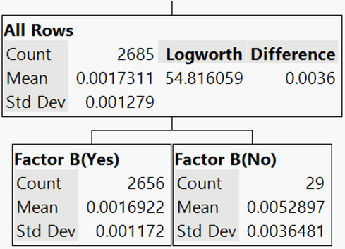

I am doing data mining to profile and quantify the factors vs responses effect.
To put it simple, I have 2 factors (categorical with 2 levels) and 1 response (yield loss) which is a percentage.
We record each day's yield loss vs what 2 factors level we are using on that day.
For each day, our quantity produce is different.
The modeling technique I'm using is Partition.
Partition directly calculate Mean percentage as show in the output below.
As each day the quantity we produce is different, it is not accurate that Partition will simply calculate the Mean of the Yield Loss%.
My question is:
1. How do we calculate the Mean weighted percentage in this case using Partition? I'm seeing an option in the Partition Platform for "Weight", but I'm not sure how to utilize that.
2. Is there a feature in Partition we could use Median instead of Mean? (since the yield loss distribution are generally skewed).

Hi @Zappy,
You could maybe add a column with the number of batches/quantity per day, and use this information as Frequency information when launching the Partition platform : https://www.jmp.com/support/help/en/18.2/#page/jmp/launch-the-partition-platform.shtml#ww1276002
The Decision Tree do not create splits directly based on mean values, see https://www.jmp.com/support/help/en/18.2/#page/jmp/statistical-details-for-the-splitting-criterion.s... for more info. So I think you could still get valuable insights using the platform directly.
If not, you could maybe try transforming your data, maybe by binning your raw data into classes of values first or log-transform your raw data (if the distribution is approximately log-normal), before partitioning with Decision Tree ?
