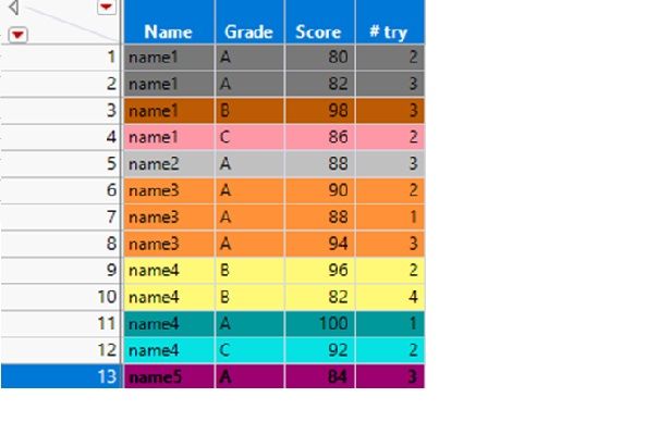

Hi All,
I am trying to  plot graphs  (script , JMP 13) with reference lines for each element of my table summary (graph of score vs # try for each Name+Grade, then add reference line of 25 and 75 percentile of Score on x axis). Would appreciate any comment
NameGradeScore# try
name1A80
2
name1A823
name1B983
name1C862
name2A883
name3A902
name3A881
name3A943
name4B962
name4B824
name4A1001
name4C922
name5A843

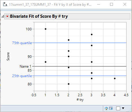

Thanks @Craige_Hales for the link, but my main difficulty is how to program to output the individual graphs as each have their own reference lines, more clearly, I am wondering how to generate graphs for each color in this data table :
Thanks!

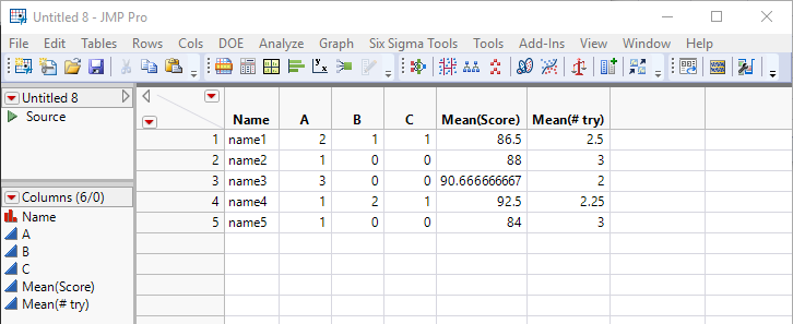

  You could do it a couple ways though. I took your table and brought it into JMP, and here's what I did (assuming I am thinking about it the same way as you):
Tabulate by Name (A, B, C are the # tries), this helps to get the means, but you can script this separately if needed.

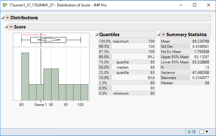

With this at hand, I graphed it a couple different ways: bivariate fit or histogram (histogram already has the quartile info readily available from the box plot). and then you can add reference lines via the normal way.
For scripting all this out, be sure to use the red hot button to get to the actual JSL script to generate what you want. But again, if you save the script to the data table, then each time you open up the data table, you can click the green hot button and re-run it quickly.

Thanks @SDF1  for your reply and sorry for not being very clear. Here I would like to explain a little more:
first of all, I am trying to write the script in a separate script window so I can run it independently, here is the first part of the script where I am trying to get the summary:
Names Default To Here( 1 );
dt = Current Data Table();
Summary = dt << Summary(
	Group( :Name, :Grade ),
	Median( :Score ),
// other statistics can be added here//
	Link to Original Data Table( 0 )
the Output will look like this :
Now , What I really want is the 9 graphs ( Score vs # try) (one for each row (having N Rows datapoints) ), and then use the statistics of each group to add to the reference lines ( all by scripting).
In your graph example, looks it is for name1 with any Grade.
Thanks
Thanks!

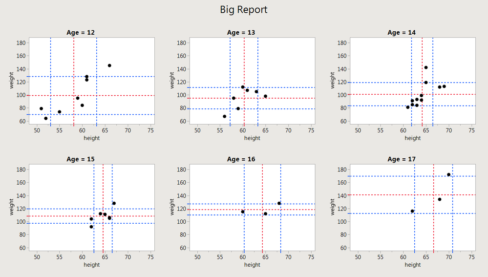

Maybe something like this
dtBigClass = Open( "$sample_data/big class.jmp" );
dtage = dtBigClass << Summary( Group( :age ) ); // makes a small table of unique ages
ages = dtage[0, 1]; // [12, 13, 14, 15, 16, 17]
Close( dtage, "nosave" ); // table no longer needed
grid = Lineup Box( N Col( 3 ), spacing( 20, 30 ) ); // Horz,Vert extra space between graphs in pixels
For( iAge = 1, iAge <= N Rows( ages ), iAge += 1, // for each age...
	dtBigClass << selectwhere( age == ages[iAge] );
	dtSubset = dtBigClass << subset( selectedrows( 1 ), linked( 1 ), "invisible" );
	// the summary will be a single row with the requested information
	dtSummary = dtSubset << Summary( Mean( :height ), Mean( :weight ), Std Dev( :height ), Std Dev( :weight ), Freq( "None" ), Weight( "None" ) );
	// grab the values of interest in simpler variable names
	heightMean = dtSummary:name( "Mean(height)" )[1]; // row one has the answers
	heightStdDev = dtSummary:name( "Std Dev(height)" )[1];
	weightMean = dtSummary:name( "Mean(weight)" )[1];
	weightStdDev = dtSummary:name( "Std Dev(weight)" )[1];
	Close( dtSummary, "nosave" ); // close the work table, no longer needed
	// make a graph, attach to a borderbox so it does not open in a window...
	bb = Border Box(
		dtSubset << Graph Builder(
			Size( 400, 300 ),
			Show Control Panel( 0 ),
			Show Legend( 0 ), // don't need a legend
			Variables( X( :height ), Y( :weight ) ),
			Elements( Points( X, Y, Legend( 5 ) ) ),
			// add ref lines. You can get a script like this GraphBuilder script by
			// making a graph builder interactively, then using the red triangle->get script.
			// below, the numbers in the script have been replaced with the variables above.
			SendToReport(
				Dispatch(
					"height",
					ScaleBox,
					{Add Ref Line( heightMean, "Dotted", "Red", "", 2 ), Add Ref Line( heightMean + heightStdDev, "Dotted", "Blue", "", 2 ),
					Add Ref Line( heightMean - heightStdDev, "Dotted", "Blue", "", 2 ),
						// force all axes to be the same...
					Min( 48.2828947368421 ), Max( 75.8776488919668 ), Inc( 5 ), Minor Ticks( 1 )}
				Dispatch(
					"weight",
					ScaleBox,
					{Add Ref Line( weightMean, "Dotted", "Red", "", 2 ), Add Ref Line( weightMean + weightStdDev, "Dotted", "Blue", "", 2 ),
					Add Ref Line( weightMean - weightStdDev, "Dotted", "Blue", "", 2 ),
					Min( 55.2100840336134 ), Max( 188.127074359155 ), Inc( 20 ), Minor Ticks( 0 )}
				Dispatch( {}, "Graph Builder", FrameBox, {Marker Size( 6 ), Transparency( 1 )} ), // make the markers bigger
				Dispatch( {}, "graph title", TextEditBox, {Set Text( "Age = " || Char( ages[iAge] ) )} ), // add the age= title
				Dispatch( {}, "Graph Builder", OutlineBox, {Set Title( "" )} ) // suppress the Graph Builder title
	grid << append( bb ); // add the graph to the grid
); // the iAge loop
dtBigClass << clearRowStates; // undo the final selection
New Window( "the report", V List Box( H Center Box( Text Box( "Big Report", <<setFontSize( 20 ) ) ), grid ) );
Reports grouped in a 3-wide gridReports grouped in a 3-wide grid
