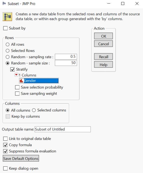

Dear JMP Community,
I have used successfully the Stratify option when creating subset tables when the stratifying variable has balanced proportions (e.g. 50% Male and 50% Female).
Now, I need to create a table subset where the stratifying variable is "unbalanced" (e.g. 25% Male and 75% Female). When I execute the Subset with stratification on Gender, the subset table returns 50% Male and 50% Female which is not representative. Hence my question: is there a method to maintain Proportion Balance when using the Subset command with Stratify?

Re: How to Maintain Proportion Balance when Using Subset with Stratify?
I don't think I've ever used random w/ sample size in conjunction with stratify.  Is that whjat you're intending, or did you want sampling rate?  Sampling rate gives me 129 results, groups split by 100 and 29.

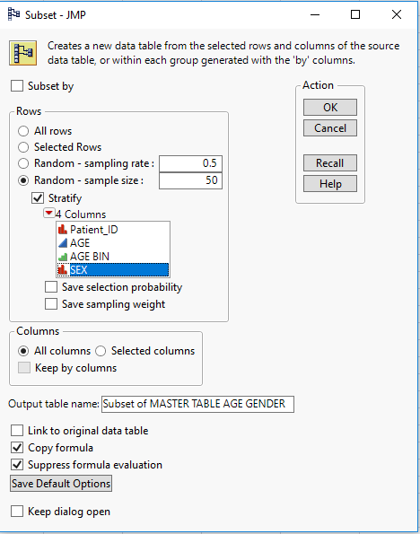

Which version of JMP are you using? I cannot reproduce this behavior in version 14. Make sure you have the dialog completed properly, too.
Hi Dan,
Thanks for looking into my issue. I use JMP 13.1.0 following the same procedure as depicted in your screen capture.
Let me create a dummy file to share with you.

Thierry_S
Dan,
Here is the MASTER table and SUBSET table showing the problem I have with the Stratification option
MASTER: 77% FEMALE and 23% MALE (see attached)
SUBSET: 50% FEMALE and 50% MALE (see attached)

Thierry_S
Hi Mike,
Yes it is my intention: I would like to select 100 patients to conduct a pilot experiment. But, I just checked the Sampling Rate method and it does not have the issue so I will look into that method instead.
