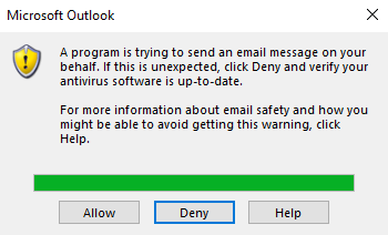

I just ran this script:
Mail(
	"[email protected]",
	"Test of Mail Client",
	"Hope you get my letter!"
I got an alert from Microsoft Outlook, the default mail client on my work computer:
I clicked Allow and the mail was sent. The message appeared in my inbox a moment later.
