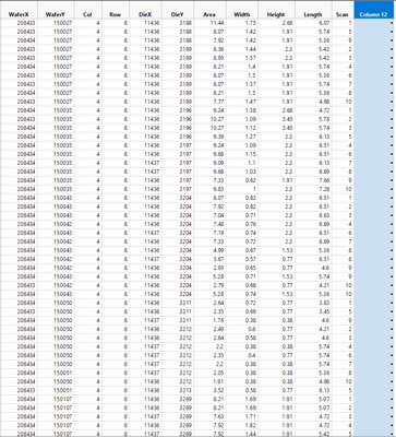

Hi,
I am trying to create a new column based on column "DieY"
I want continuous count based on the difference between each row and the previous one.
row 2-row 1, row 3-row 2, row 4-row 3 and so on.
if the difference is below a certain value, e.g. 5, set the value to 1.
if the difference is above, add 1 to the count.
keep the last count until the difference is above the value set in the formula.
so eventually I will have a new column with values such as: 1,1,1,1,1,1,1,2,2,2,2,2,2,2,3,3,3,3,3,3,3 and so on..
Many thanks to any help

Here is the formula I came up with
If(
	Row() == 1, count = 1,
	:DieY - Lag( :DieY ) > 5, count
count;
