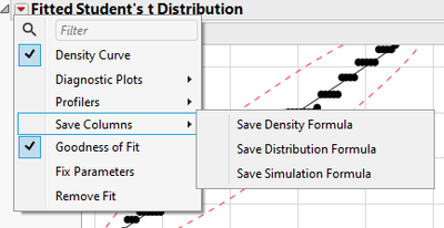

Hi All,
I had to transform a variable to a student t distribution, nice and easy in JMP using Analyze << Distribution << Selecting your variable then clicking the red arrow and using the continuous fit selection, is the back transformation is just as easy?? Can someone explain the correct menu selections for this to happen.
Thanks

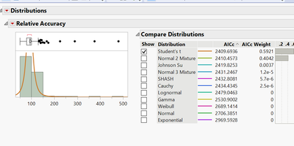

@MRB3855, the reason l asked that question was because of the output from JMP for compare distributions in my previous post, l haven't heard of a lot of these distribution, Johnson Su, SHASH, Cauchy, Gamma, Weibull and l thought it's one thing to transform your variable to something that approaches a normal distribution, and it's very easy to do in JMP as highlighted above, but how do you back transform. l thought there might be a nice and easy way to back transform that l wasn't aware of, that's all.

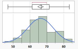

1. If you used PDF: All this does is create the t distribution curve (the blue line in pic below).So, for each X (x-axis) you will get a point (y-axis) on the blue curve if you apply this function.
2. If you used CDF: All this does is calculate area under the curve (probability) of the PDF. In the example below, the area under the blue line to X=65.104 is 0.439265. So, Prob(X<65.104) = 0.439265 if X has a t-distribution (given your values of Location, Scale, and DF). So, for each X you will get a probability. if you apply this function.
So, whichever function you choose, PDF or CDF, it can't result in a normal distribution (or t-distribution); all it does is assume your data is from a t-distribution and then generate a curve and/or calculate probabilities. In fact, the CDF (no matter what the distribution of X is) has a Uniform Distribution (special case, = b =1, of the Beta Distribution), but that is another topic for perhaps another day.
